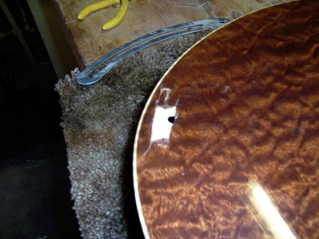

Here is the hole. I have taped a scrap piece of spruce backing plate to hold the the missing pieces level during glue up.

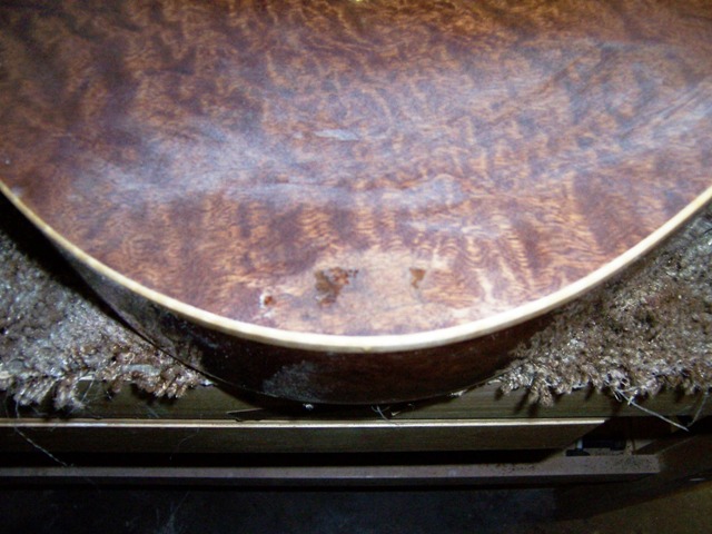

Here is the repair before sand down and re-seal
MichaelP38951.6812962963

PostPosted: Thu Aug 24, 2006 12:25 am
I did not take any others of the repair process. It was pretty simple since the pieces that were knocked out were in tact in relation ship to the their mating edges.
First I sanded back to wood level at the repair site. Then taped a thin piece of spruce in side to make a deck for the loose pieces to set on. the pieces were cleaned and test fitted then hide glued back in place. and allowed to cure over night. I then removed the spruce that I had taped to the inside, sanded the entire back level to wood, washed with a 60/40 mix of DA and Zpoxy, allowed to cure over night, lightly sanded, sealed with shellac and reapplied finish to the back.
